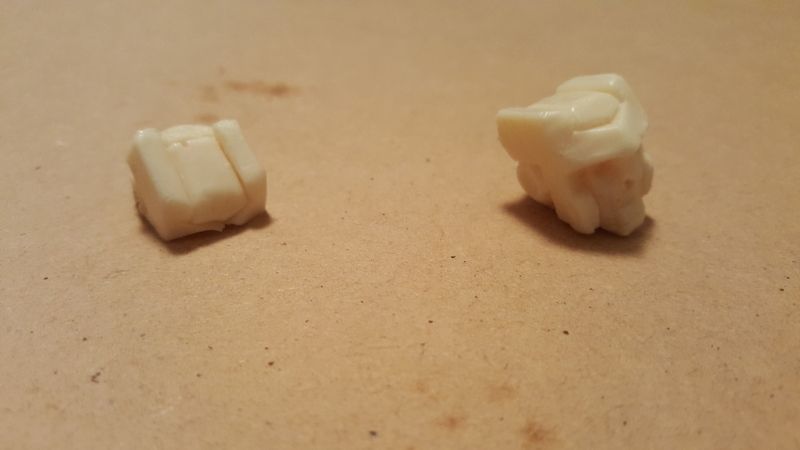

    31st Mar 2016
    118
    Interesting to read about your findings. I just try to orientate the parts so the bubbles flow away from the surface with gravity.
    Yeah I tried as best I can to let the air run out. I think because of how rough the pieces are they trap more air.
    do you use liquid or talc or something else for release?
    I cast inside a pop top lid and it came out smooth as with little bubbling, so im pretty sure its the finish of the parts causing some issues. I've read that every crease on detail is a chance for bubbles
    31st Mar 2016
    118
    I will kepp the pics to a minimum but the quality of this cast is vastly superior to previous ones. the finish on the piece looks more of a matte finish but it is very very smooth compared to the others, they only got small patches of glass here and there. Also bubble elimination is a lot better too.
    New one on the right
